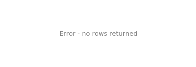

Sometimes when using python code, there will be cases when no data is returned. To account for this in python if you can first check if the dataframe has empty rows with
if df.size == 0:
  (then run all of my actual code)
else:
  (run code to show error message)
With python matplotlib charts, this can be accomplished as follow:

# Function that defines the error text
def error_text():
  ax.text(x = 0.5, y = 0.5, s = 'Please input site_id into salesforce',
            horizontalalignment='center',
             verticalalignment='center',
           color = 'gray', fontsize = 20, family = 'sans-serif')
  return ax
# Final logic to figure out if an error message should be returned
if df.size == 0:
  periscope.output(error_text())
else:
  periscope.output(actual_text())
Note: Another post that outlines a similar methodology can be found here.
