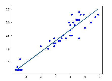

Let's look at the model, comparing it to our test data.
#plot the predicted trend line
plt.plot(X_test.flatten(),y_test.flatten(),'bo',X_test.flatten(), predictions.flatten())
periscope.output(plt)
