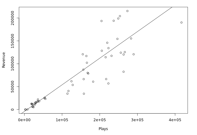

Now let's say you want to plot your linear regression line against your test data. Take out the periscope.table(test) line and write the following lines of code, and select your chart type as R Image
linear_regression_plot <- plot(test$total_plays,test$total_revenue, xlab = "Plays", ylab="Revenue")
abline(model)
periscope.image(linear_regression_plot)
This gives the below result:

  • Thanks for the example. It illustrates the importance of being able to quickly visualize your data: it shows "group" heteroskedasticity, splitting the data at about plays = 70,000, which calls for building separate models for the two subsets since they seem to represent two very different populations.
