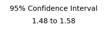

Let's say we want a printout of our confidence interval for an entire sample (Note, if you're looking for a visual of a confidence interval over time, check out the post here!) The solution here requires Periscope Data's Python/R Integration as we'll be using Python's Scipy package and matplotlib text charts.
Our SQL output is a dataframe (df) with one column of a list of values.  Notice that the function created in the Python snippet also takes in the following optional parameters for added customization:

  plt.text(.5, .75, str(round(interval * 100))+ '% Confidence Interval', fontsize=25, color='black', ha='center')
  plt.text(.5, .35, str(round(lower_bound[0],2)) + ' to ' + str(round(upper_bound[0],2)), fontsize=25, color='black', ha='center')
  return plt
# Use Periscope to visualize a dataframe or an image by passing data to periscope.output()
periscope.output(CI_printout(df))
