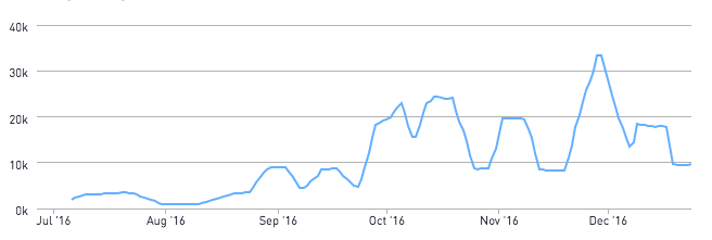

Now, we make this chart a line graph to visualize the rolling average line by itself!
